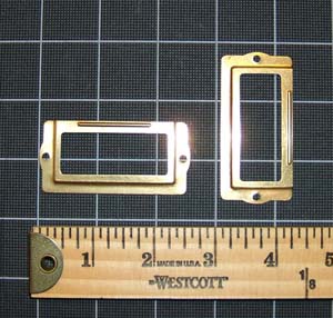

nice! how about a small plexi window so you can see which module is installed? or maybe one of these :) and just slip in a piece of paper...

nice! how about a small plexi window so you can see which module is installed...
Windows would be cool! With LEDs inside to illuminate the modules, of course. Let me think about that...
