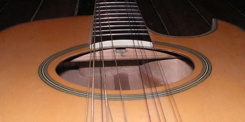

What's the catch? I'm so glad you asked. Not much. A little thing, but it means so much. This guitar is missing a truss rod nut. probably metric size, probably you could get a replacement from Stew-Mac. (it -might- be the thing that's rattling around inside the guitar)
But without the truss rod nut, the truss rod is loose, and the tension of the 12 strings bends the neck so the action is ridiculously high. It should be an easy fix! you can see the hole where the truss rod nut goes in the brace just above the soundhole.
