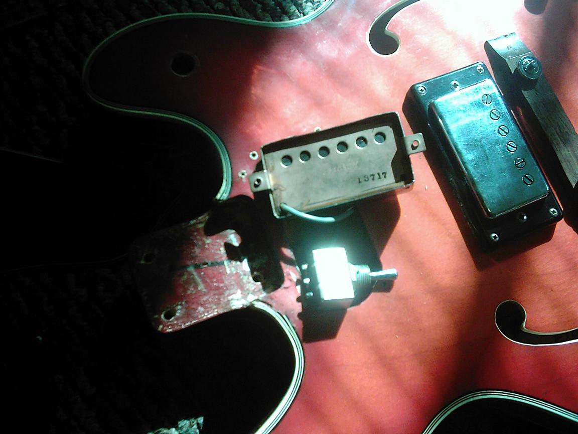

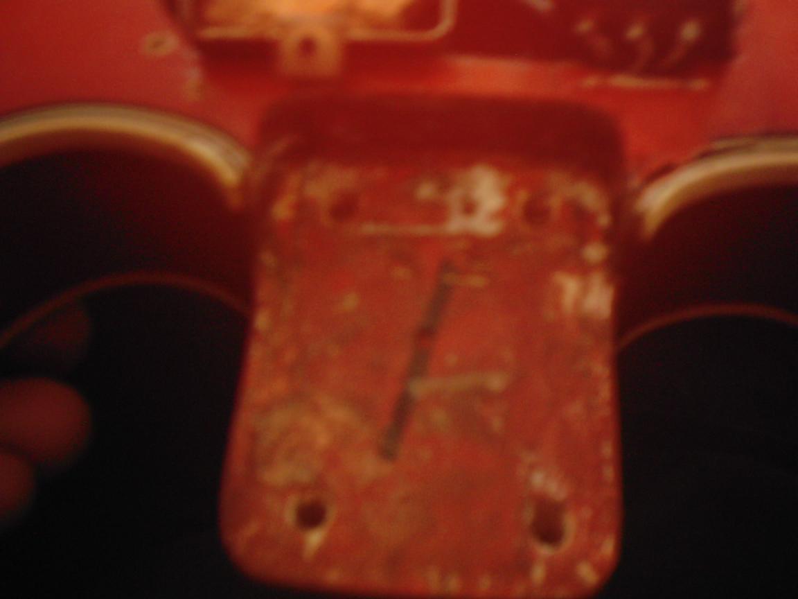

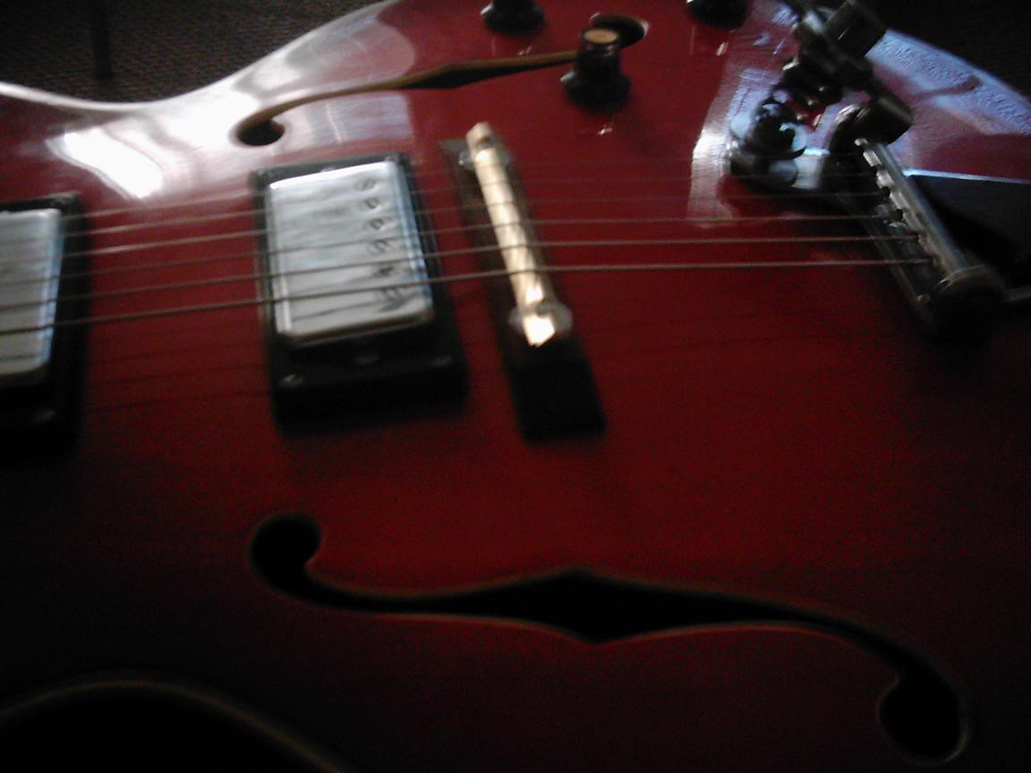

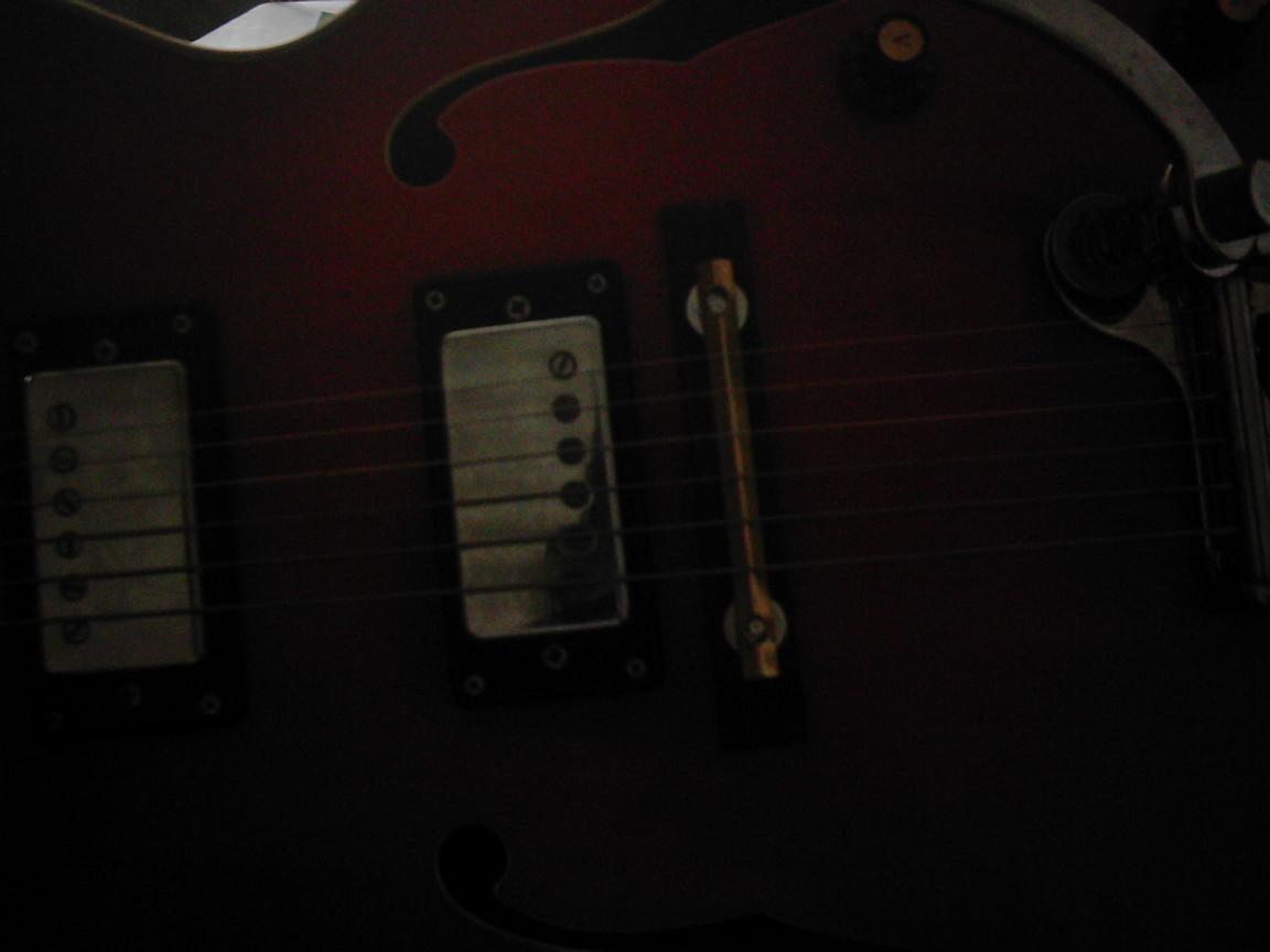

PICS! Sorry for the poor quality / lighting on these; my camera sucks!

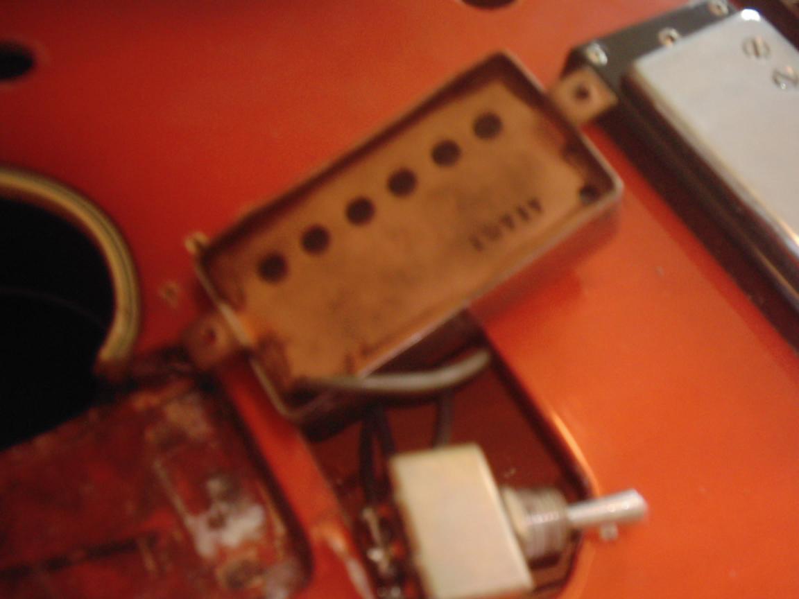

And a few before pics from the ebay listing:
