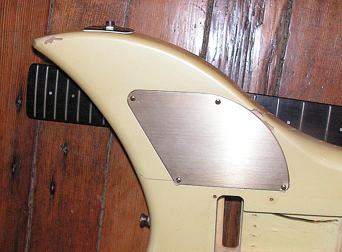

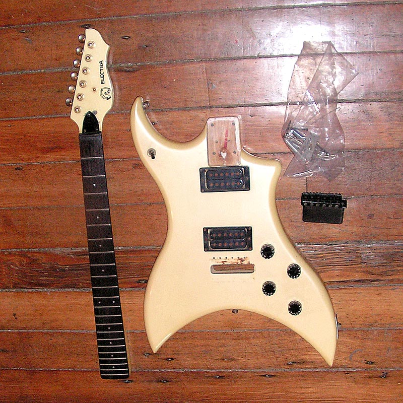

It's a 1982 XV1PW Pearl White Futura! This is a project guitar, what you see is what you get.
This is going to make someone very happy. This is an uncommon model, and this should be an easy and successful repair.
It's hard to see at first, but the entire lower leg of the body is cracked in several places and basically hanging together by matchsticks and the screws on the control cover. At first you wonder what could have caused this damage, and then it all falls into place- this guitar was smashed. In the days of homebrew punk rock, smashign guitars was cool, and what better to destroy than something so glam and beautiful as a Futura? I know, it makes me sick too.
But this should be a solid repair- you'll need to take it apart and use gorilla glue and clamps, but after that it'll be solid as a rock. The original gold neckplate appears to be missing, but I believe it shoudlb e standard (and I may have a replacement)
This isn't the original bridge, it should be gold. This is in fact a very rare Tekglide bridge from another Electra Phoenix. Normally I wouldn't consider using an incorrect bridge which is so badly needed for other correct restorations, but this bridge will bring this Futura back to life again. Do me a favor, and if you can ever find a gold bridge (original or repro) send me this bridge back again. But for now, it should go with this guitar. This guitar needs to come back to life in the hands of someone who appreciates it.
The electronics are 'LP-style' with seperate volume & tone knobs for each pickup. The tone knobs are pull-switches to activate coil tap and phase reverse. Like the Electra Phoenix to which this is an exotic sibling, the tonal range of this guitar is great, thanks to the MMK45's. Like many pointy guitars, this was a flagship model designed to hang in the music store and attract attention (even though what they went home with might be more sedate) as such it got a lot of attention and TLC, and I know that's going to be apparent when this one is bakc together.
And that's the catch: you have to agree to give this one a good home- it's an uncommon guitar, and not everybody loves the pointy Electras! It shouldn't be hard to fix, jsut agree to give it a new chance and I'll be glad to help you with the repair.

This ones got my interest too! Has a pair of MMK45's in it (I just had to pop them out to verify!), the phase/coil cut push pulls, just like the Endorsers! All it needs is a neck plate and four neck screws, I'll have to think long and hard over this... Mike.

Two Observations on this one. First, the crack, while SIGNIFICANT, did not completely disturb the paint on the front. In other words, it's not that obvious from the front. Secondly, when we were putting all the guitars up for a group photo, we slipped the neck in and we were all really impressed at how Tight the neck joint was. The neck stayed in place even when being leaned up against the wall, and we had to give it a good tug to get them back apart, pretty impressive for something that was smacked hard enough to crack the body that bad.
I would have liked to plug this into an amp, and I think it's a straight forward enough project that even I could have taken a stab at it. I am not kidding when I say I was really, really close to choosing this one, even though three totally playable guitars and the outlaw were staring at me.

I have the guitar glued and clamped so fingers crossed I did it right.
I got a neck plate and three screws (for neck security only).
The plate is form a Squier and says Made in China, so next time I go by Jim's guitars I'll get a good MiJ neckplate and screws.
The bridge went on no issue as well, obviously.
