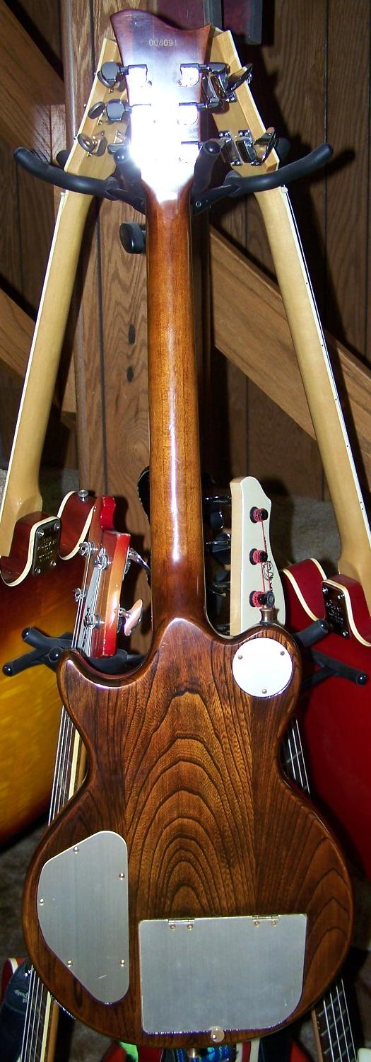

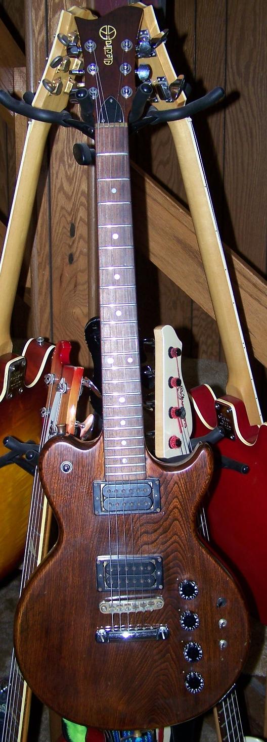

and pics...
 Post subject: Re: X960 Ultima
PostPosted: Tue Jul 17, 2012 2:50 pm
it's a 1980 build date on the headstock, but Rene Lopez signed it for set-up in November of '82.
