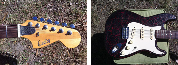

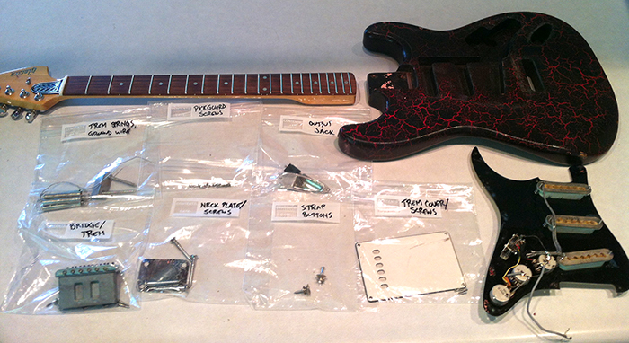

Not pretty in the photo -- much worse in person. The crackle finish rubbed off on my fingers, and it played like a worn out piece of furniture. The neck was crooked. The angle was wrong. Two neck screw holes were stripped. The nut was new, but cut too deep. The bottom strings sounded like "thunk". When the output jack stopped cutting out, the pickups howled. Undeterred, I broke it down.
Even from here, you can see the neck pocket filled with crackle and a giant shim...

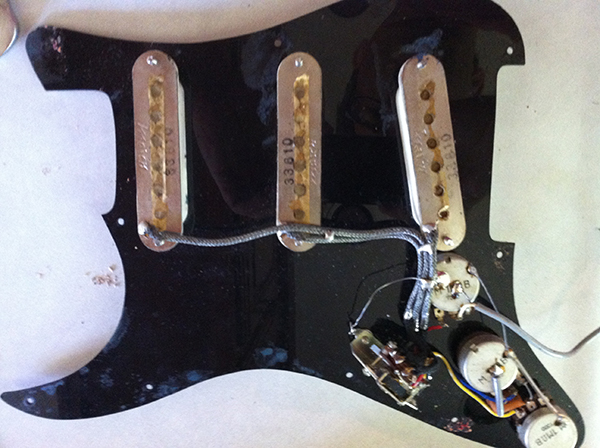

The pickup codes date to August, 1973...

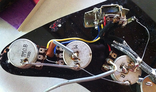

I was surprised to see 1M pots...

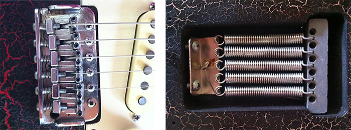

The bridge and trem were way out of adjustment, but otherwise OK...

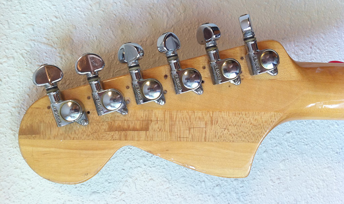

Someone replaced the original tuners with Grovers, which was fine by me...

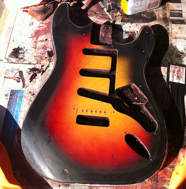

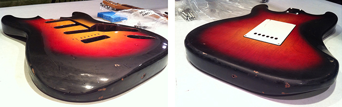

A little lacquer thinner revealed a beautiful three-color burst...
I'd planned to refinish the body, but I loved the story it told now. A natural relic!

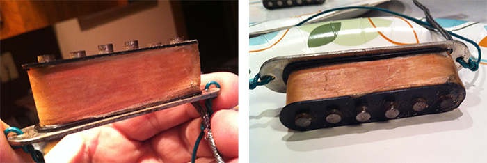

I potted the pickups with paraffin and beeswax...

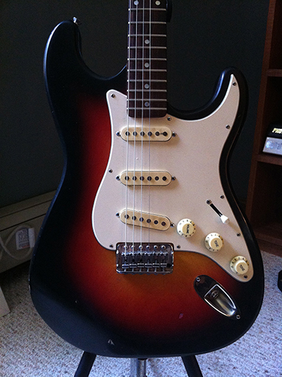

I resoldered the grounds and installed a new jack. Lightly shaving the pickguard around the pocket allowed me to straighten the neck. I replaced the shim and fixed the screw holes with toothpicks and wood glue. The nut just needed a little Super Glue and baking soda. After a setup and a new set of 10's, the difference was incredible.
The action is nice and low, and it frets as easily as any guitar I've owned. It holds intonation well, and even stays in tune with heavy trem use. (I'm more of a wiggler than a dive-bomber, but I wiggle a lot...) The pickups are extra bright --  almost like a Telecaster, with plenty of twang and harmonics. Perfect for cutting through in a loud club.

Nice job. I'm surprised at 1M pots - very unusual for single coils. If it cuts through the mix at 1M it would have to be super extra ultra painfully bright at 500k or the standard single coil 250k - wow! It's great that lacquer thinner took off the crapple. Just curious - did it really need a neck shim after it was all cleaned up? I've yet to come across an Electra that needed a shim.

Jead - it was close. After tossing the original shim (1mm thick), I went back and forth between a strip of 32-lb bond and nothing. At the time, it seemed better with the paper shim. Now you've got me thinking I should try again...

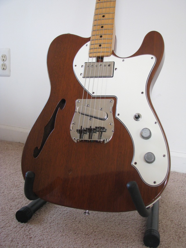

Sweeeet Resurrection!! Congrats, and thanks for sharing. If you're looking for a Tele, be patient and wait for a 2270 thinline (semi hollow) model (regardless of the logo). They are best-balanced and most nicely appointed 'Rock n Soul' model in my humble opinion. And they're pretty easy on the eyes too:

That is a thing of beauty. Point well taken!

:hyper: Yep the tele models are awesome for certain even with humbuckers like this model.
Image :hyper: :hyper: A thing of beauty and quality.
