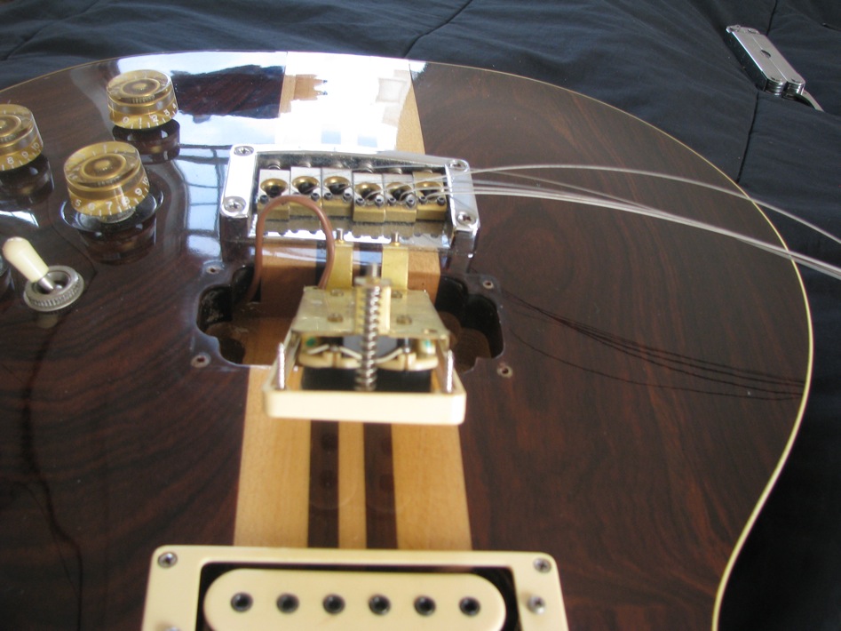

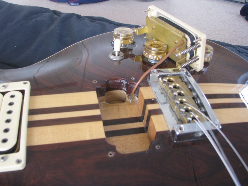

I used to own a pretty nice Falcon, gorgeous Rosewood top, you can see how thick the rosewood is in these pictures with the bridge pickup out. I couldn't get used to the weight and chunky neck, but it was a good experience. Here are two pictures of the pickup I could find:
Tom Presley told us at ElectraFest 2014 if a pickup was a Maxon, it would be marked, that they didn't let any leave house without their logo on the back. The pickups in mine had three height adjustment screws, two on the top and one on the bottom, which I believe is a very Japanese thing to do, but I am not a historian. There were no markings that I can recall on the bottom of the pickups, so I lean towards them being Gotoh, but again I'm not certain. Also in one of the photos you can see a sizable magnet underneath the bobbins but above the plate, something that should help identify the maker.
Some of the 'Wing' series were made by Matsumoku, but I don't know what period or versions those would have been. Best of luck.
