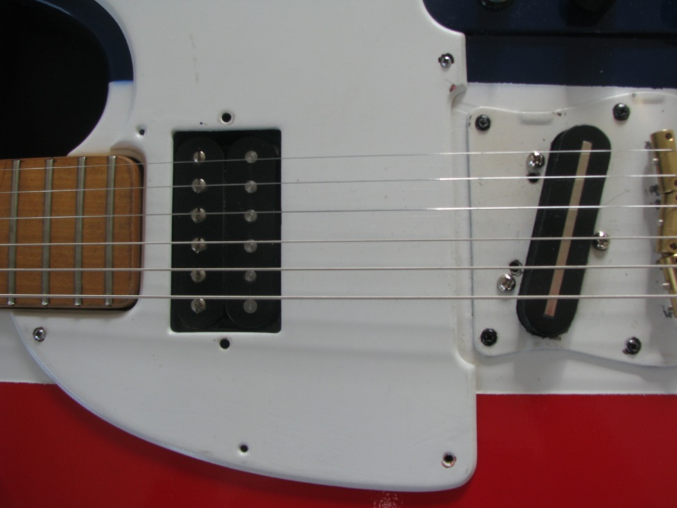

Here's the stock bridgeplate on my 2238 (body would have been all black originally...) with some compensated brass saddles I put on it. The 'Barrel' type saddles (non-grooved) worked good as the strings will find the right spacing on their own. The saddles that were on there when I bought it were grooved and the spacing was way too wide for the neck as you mentioned. One of the things I really like about this guitar is the tiny neck, may not be for everyone, but I dig it. Also has a 24.5" neck scale unlike a Fender, another plus if you ask me.
The bridge plate itself is nothing to write home about, and you can see that new holes had to be drilled to accommodate a standard Tele bridge pickup mounting screws, and as X189player and I both found out, the original hole for the bridge pickup is tiny, you either have to whittle a standard pickup down, or enlarge the hole to get one to fit.
There may be a 'string through' version, but as you can see on mine the strings thread through the back of the bridge on top, not through the body. Mine is a pretty early version with pearl (not black) fret markers only to the 17th fret, so possibly later versions had a different bridge, I don't know.
Does the bridge on yours currently have six separate saddles or three bars like mine? Is the output jack on the control plate or the side of the guitar? Post some pics and tell us how things progress, Cheers, Mike.

P.S. yeah those necks are skinny, here is a picture showing how the strings don't quite line up with the Neck pickup pole-pieces , but are correct for the neck width:

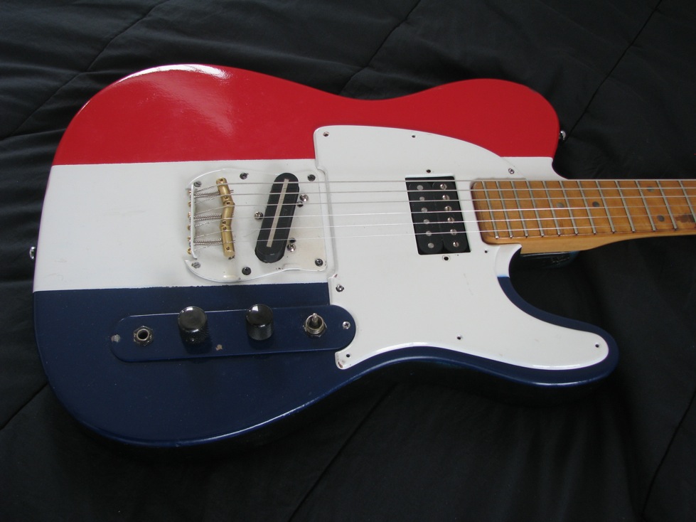

Mike, got the pics working - here are some photos of the beast:

Well heck man, that doesn't look too bad at all, in fact thats a sharp looking little guitar there Peter! I like the aged pickup switch topper, and your pickguard is much better looking than mine (and still has all the mounting screws!). The control plate on mine kinda bows up in the middle like that too.
I can't really tell how the strings line up with the neck from those pics, but I assume the E strings are getting close to the edge or you wouldn't have mentioned it in the first place. I see the extra pickup mounting holes on the bridge, which lends me to believe the pickup you took out was probably the stock (cheesy!!) pickup, or at least it was in there at one point.
You'd have to be pretty lucky to come across the stock Bridge somewhere, but I don't want to sound too pessimistic... you may be able to fabricate one from scratch, as there isn't that much too it. It may be tough to retrofit that Fender bridge with three bars like mine (which solved the spacing issue) but who knows, maybe there is enough space on the ends for (even) more holes. I had to file down the ends of the compensated brass saddles I bought (under 20 bucks) to fit close enough together, but that was easy. The six barrels you've got allow for better intonation, but don't give you any room to shave them down to fit closer together, so you do have a little bit of a dilemma there. Chew on it for a while, and tell us what you come up with.
Overall, I really like the way these tele's play, and I think it's worth the effort to get it so that you enjoy playing it, Mike.
