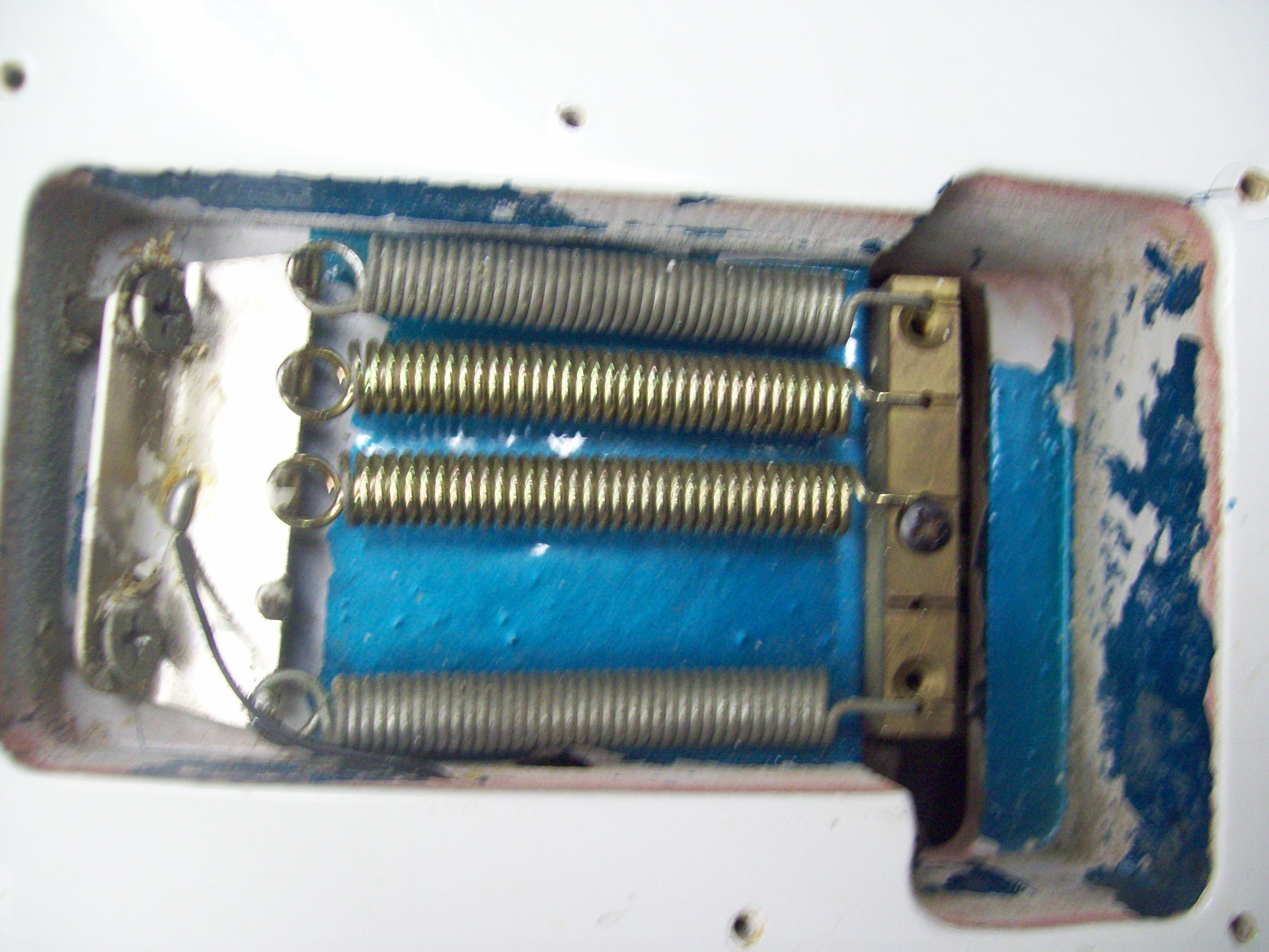

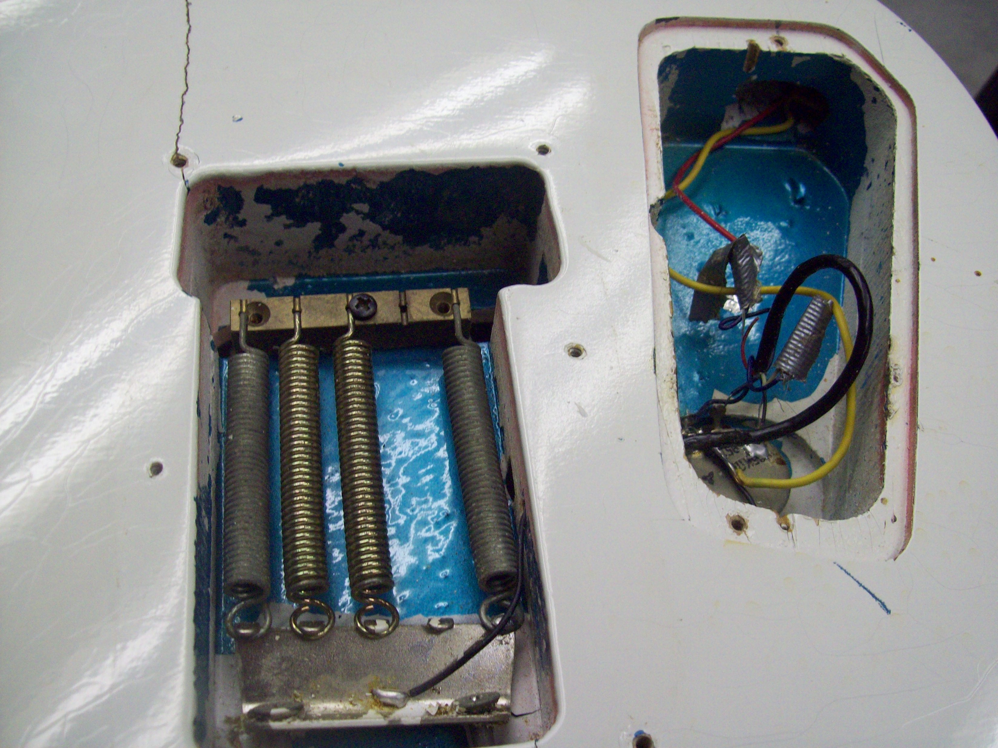

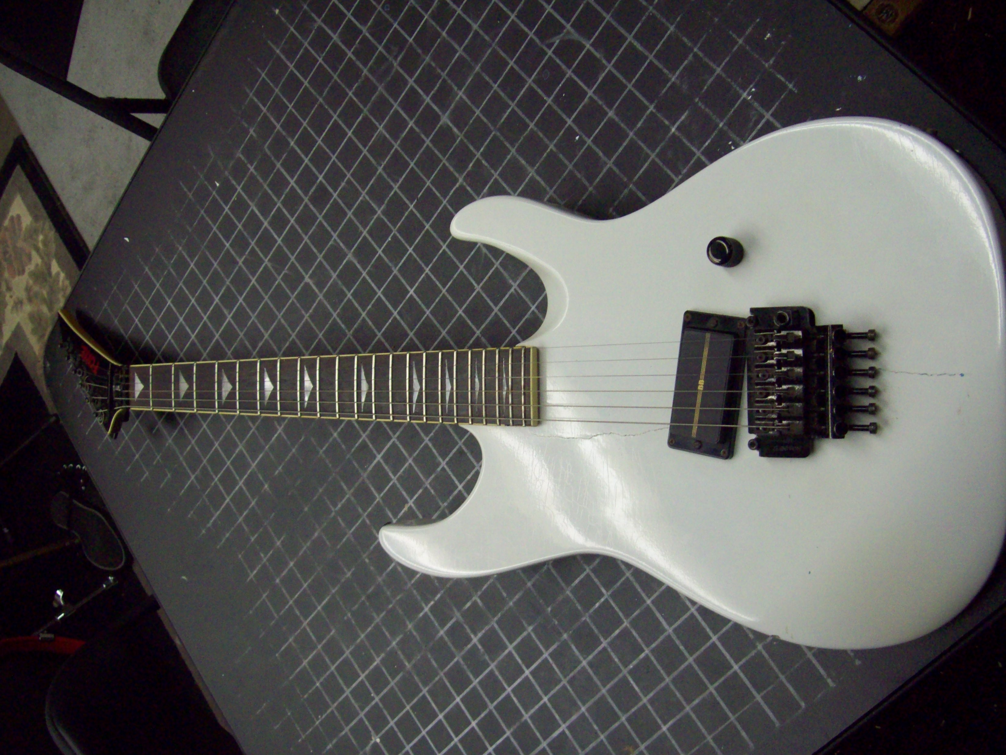

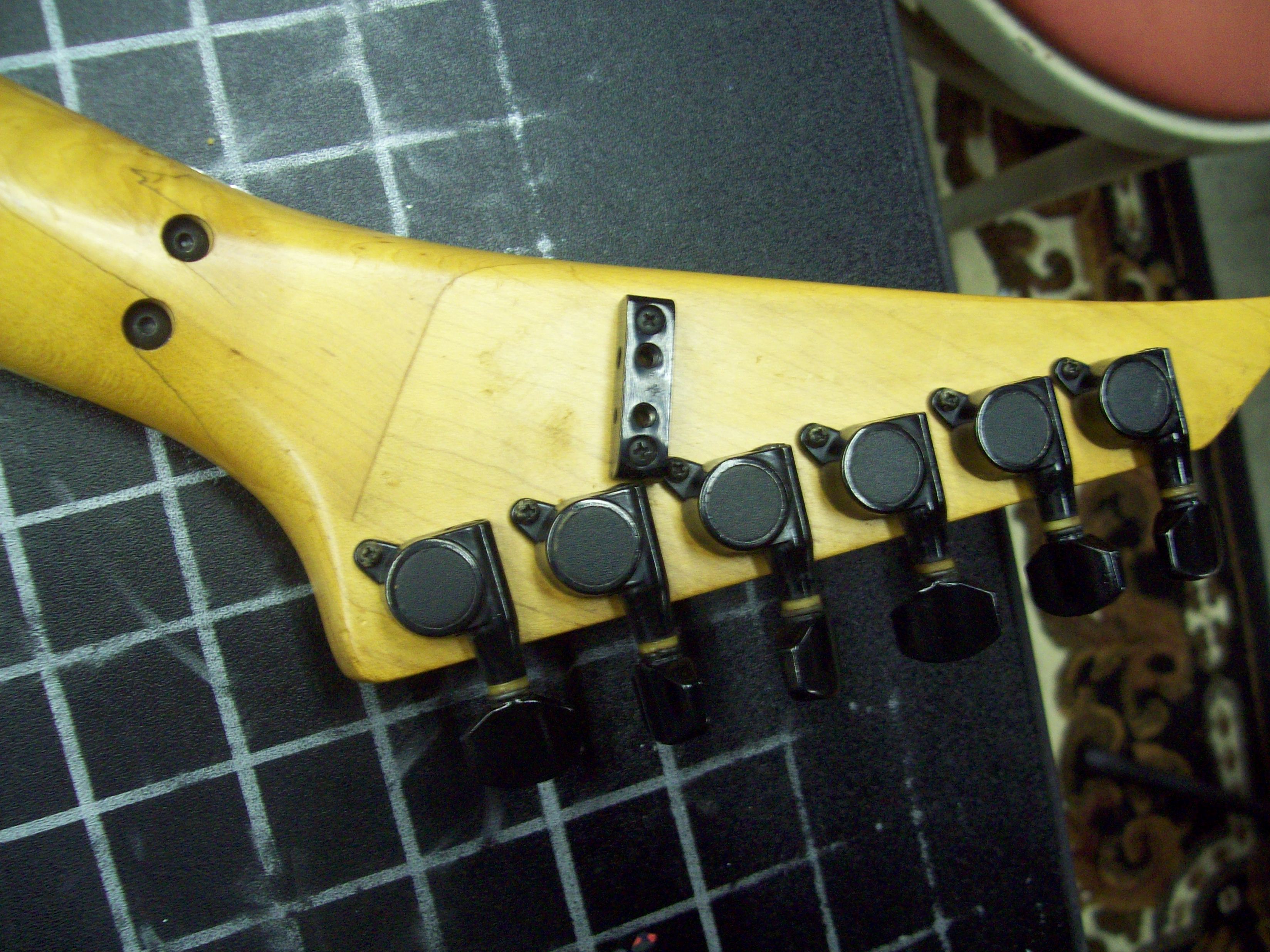

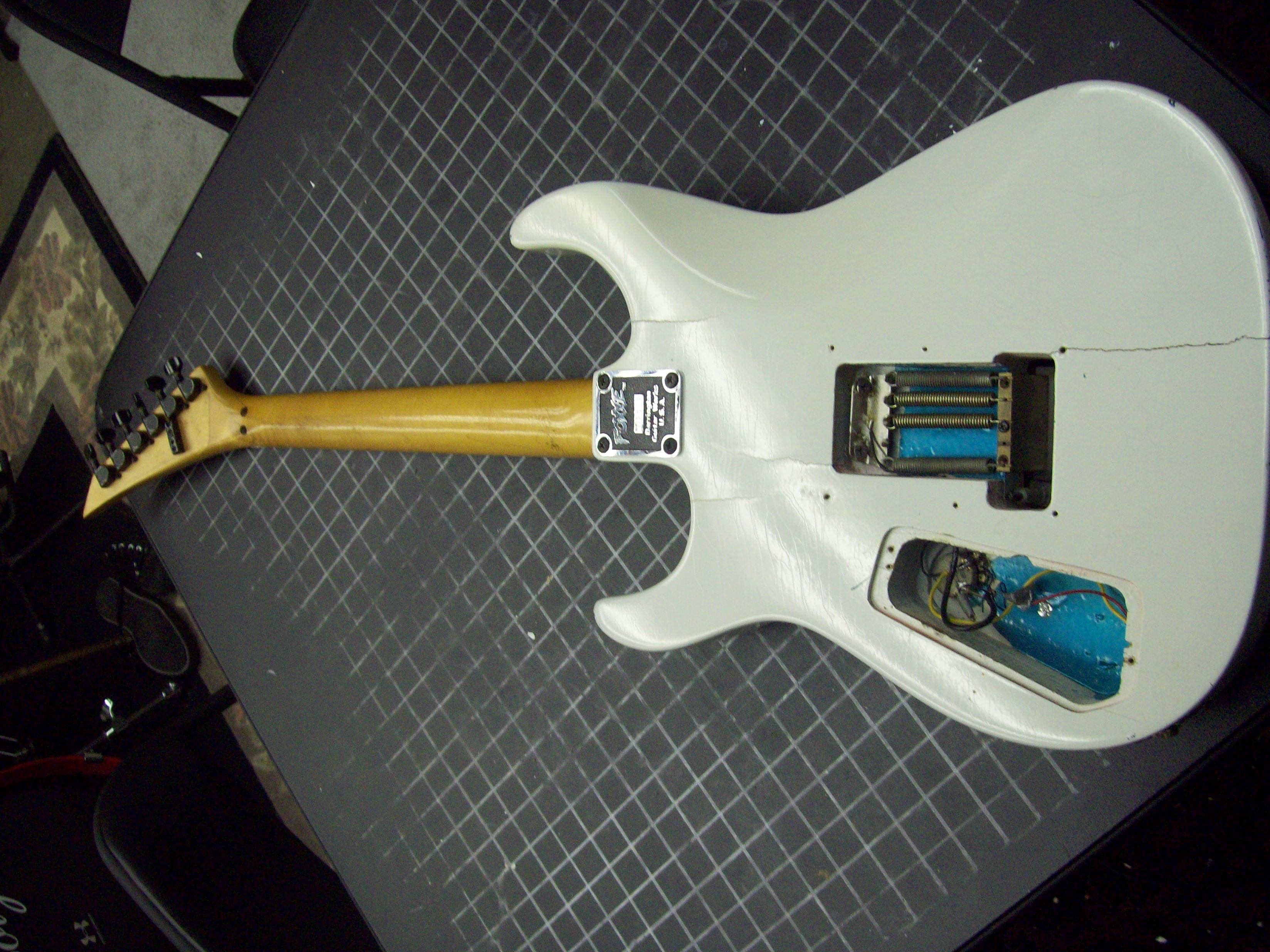

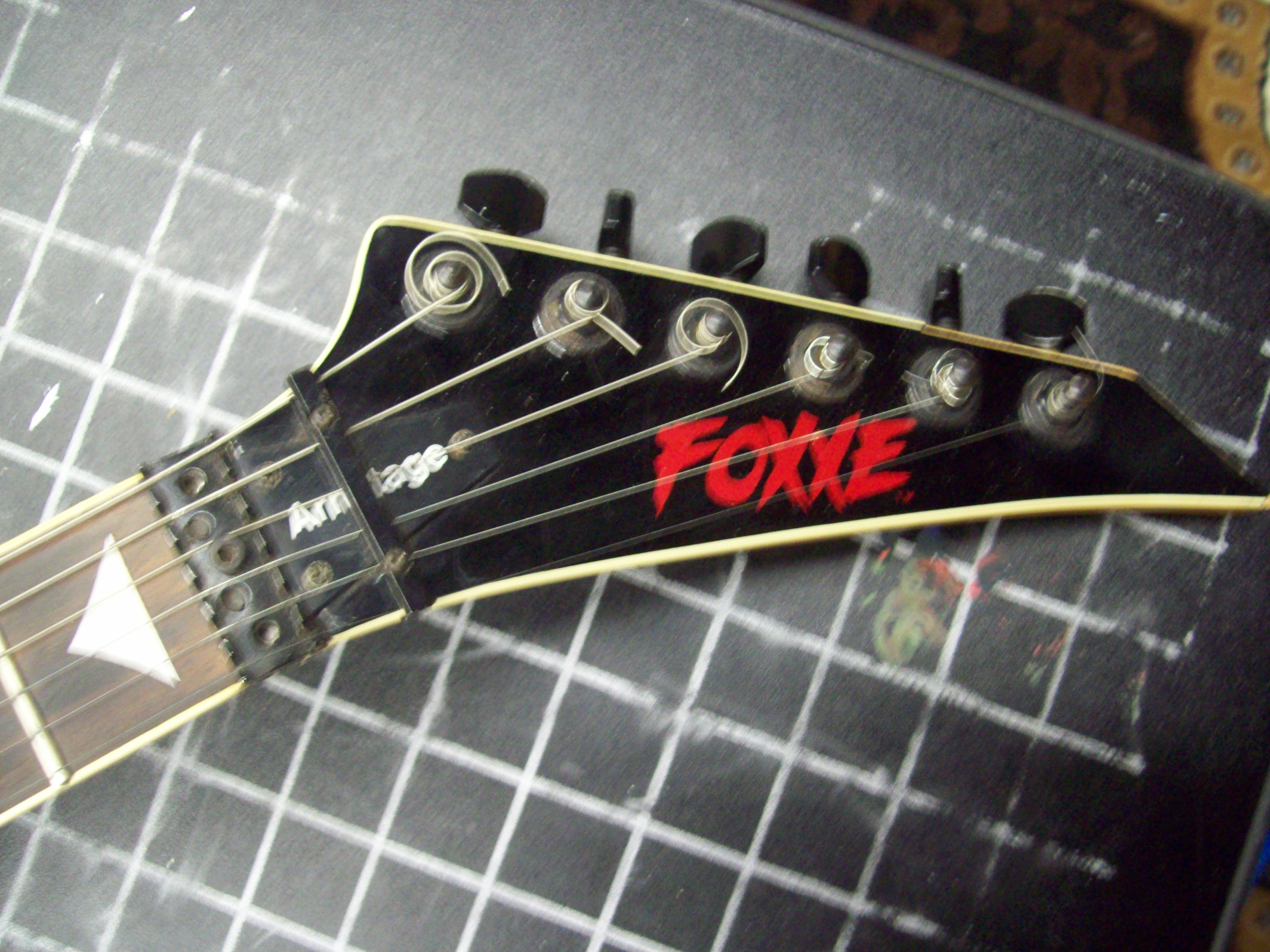

:hyper: :hyper: :huh: :huh: :huh: :hyper: Well today this old guitar just fell into my hands. Someone asked me to look at an old hard shell case to see if it was OK and this was inside. The case owner did not like nor want it. I have never heard of this brand but it looks alot like a Kramer or maybe early Japenese ESP. Single humbucker pickup and only 1 control knob(volume). Hardware is very nice(gotoh Floyd Rose Lic copy locking trem and Gotoh tuners also I believe.) Solid maple neck wide 1 piece like a kramer bolt on. Neckplate says Foxxe Barrington Guitar Works USA The finish now is white and looks horrendous. After opening up the back cavity I found it to be a fair overpait of the original and very nice looking Aqua Blue color. I would like to remove the white paint finish and go back to the original Aqua finish but I have never attempted to remove one finish over another. The white finish is a nice job originaly but has cracked over the years. Any help or ideas on how to remove the white paint and not damage the original finish underneath/ I have never seen on of these guitars before but it plays very well and also sounds nice. Plenty of power and volume from the single pup. No idea what make the pup is. It is a black covered humbucker with gold BB letters on top. with a three lines of small gold across the top with BB in the middle of the pup.The pickup is angled same as the older Kramer guitars and is just in front of the trem bridge assy. Fretboard is rosewood with a strange inlay(Almost like the markers on a X410 Jazz Strad. Will be posting pics also. Thanks Arthur :huh: :huh:

Arthur - Is there poly or some kind of clear coat over the paint? If there is, try lacquer thinner or acetone in a small spot and see if the finish softens. If it does, then you can use either of those products to get down to the white paint. If there's a clear coat but the lacquer thinner or acetone doesn't soften it up then I have to recommend a heat gun. If there is no clear coat, I would try some regular paint stripper but very carefully. If the aqua has a clear coat over it, you're probably good to go with the paint stripper - the best case scenario would be no clear coat over the white - paint strip to find a clear coat over the aqua. Worst case would be poly over the white and no clear coat over the aqua.

PostPosted: Wed Jul 20, 2011 6:54 pm

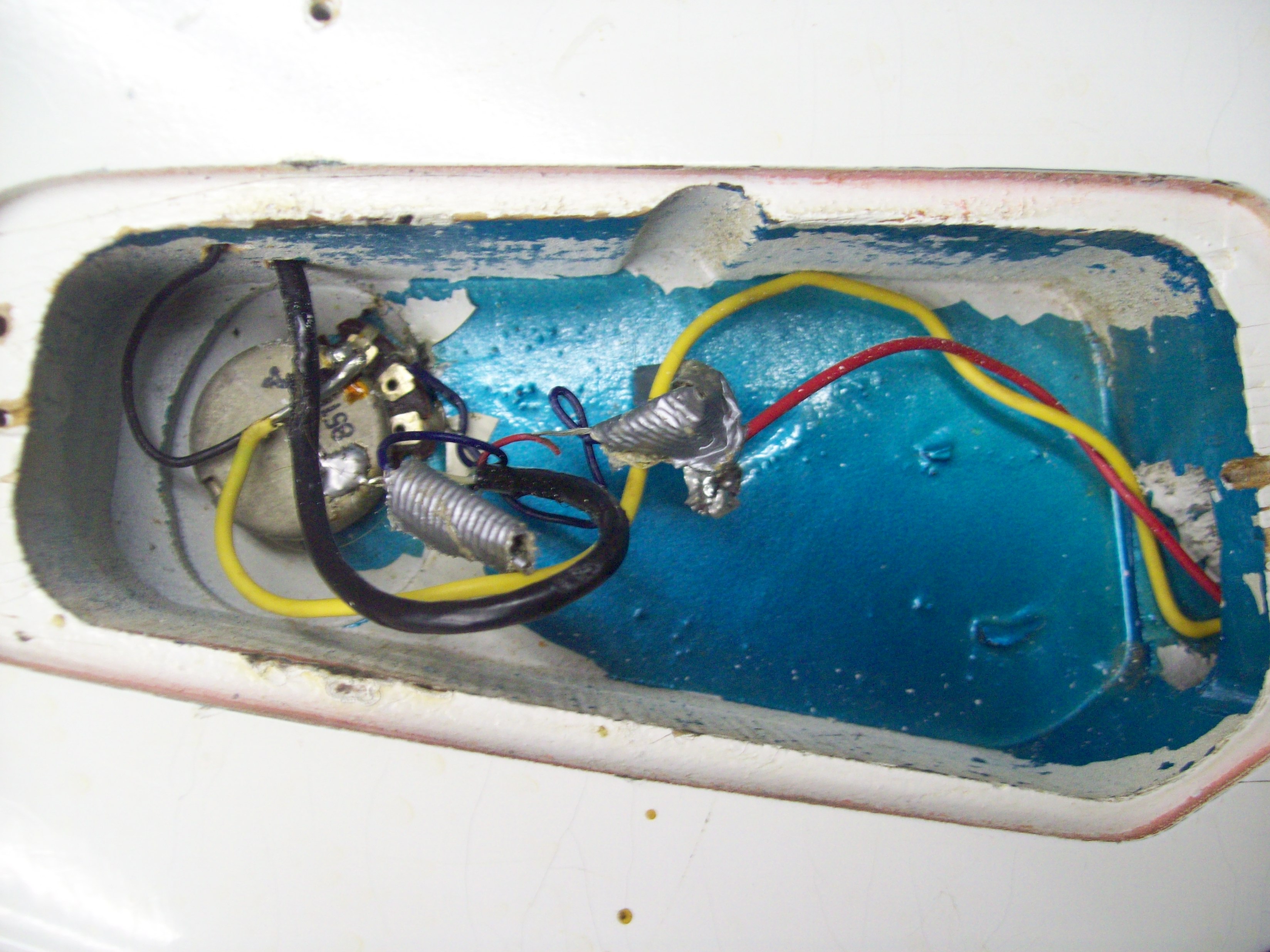

It is white now but inside the trem and control cavity you can see the Aqua blue color. The white paint is thin but looks like it may be a very thin if any coating over the paint.I will post some pics in the AM and would greatly appreciate any input and help. From what I have found on the Kramer forums and the net these guitars assembled in Barrington Ind USA by the early partner of Kramer and were assembled from parts made by ESP and terrada in Japan. That makes sense as the parts neck and body are solid and nice. Has the early ESP and kramer style neck with wide neck. These were only made for 2 or so years in or around 89-91 and were made to compete with the Kramers. I will get some good pics up in AM. Thanks again. :look: :huh:

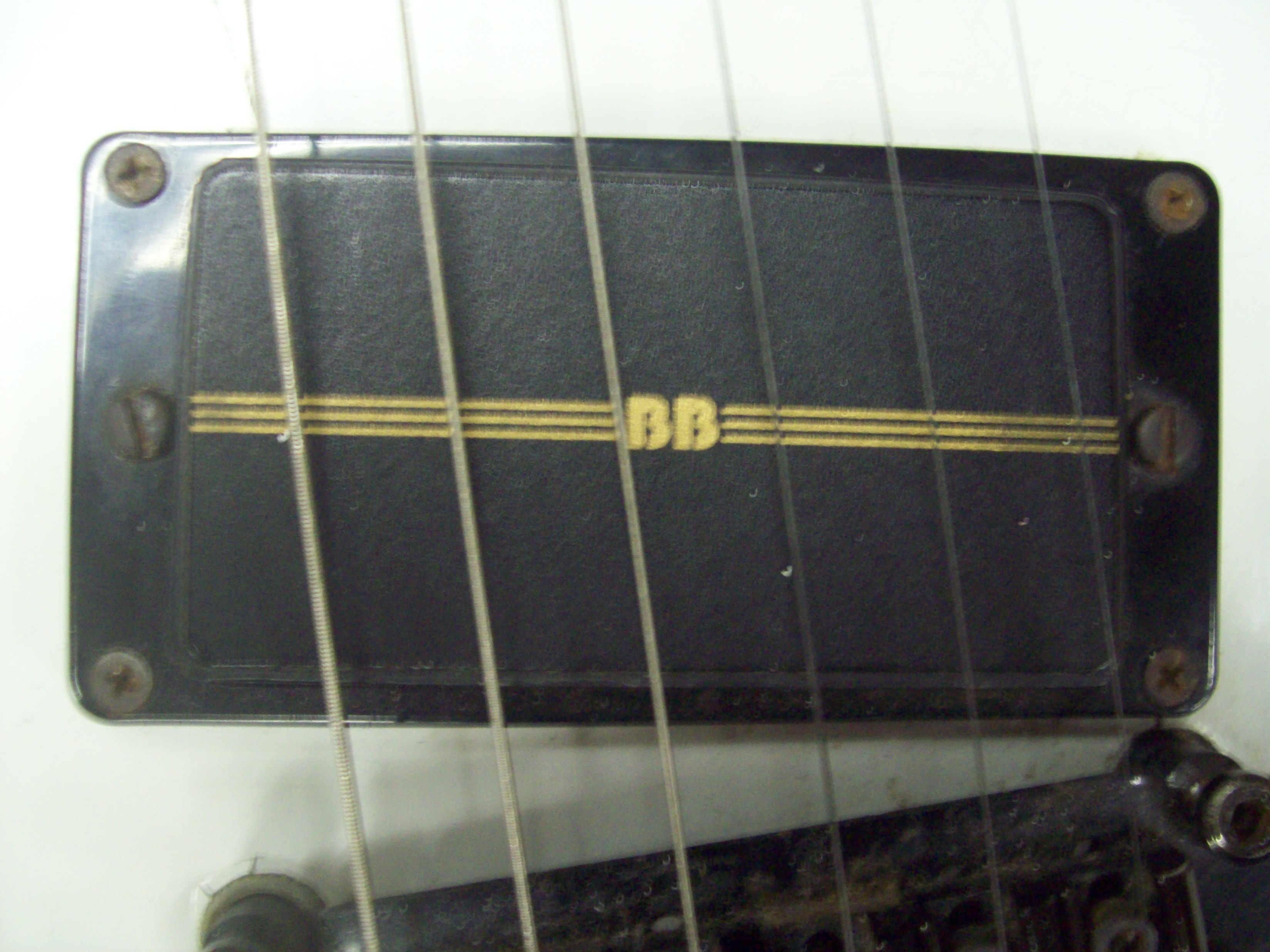

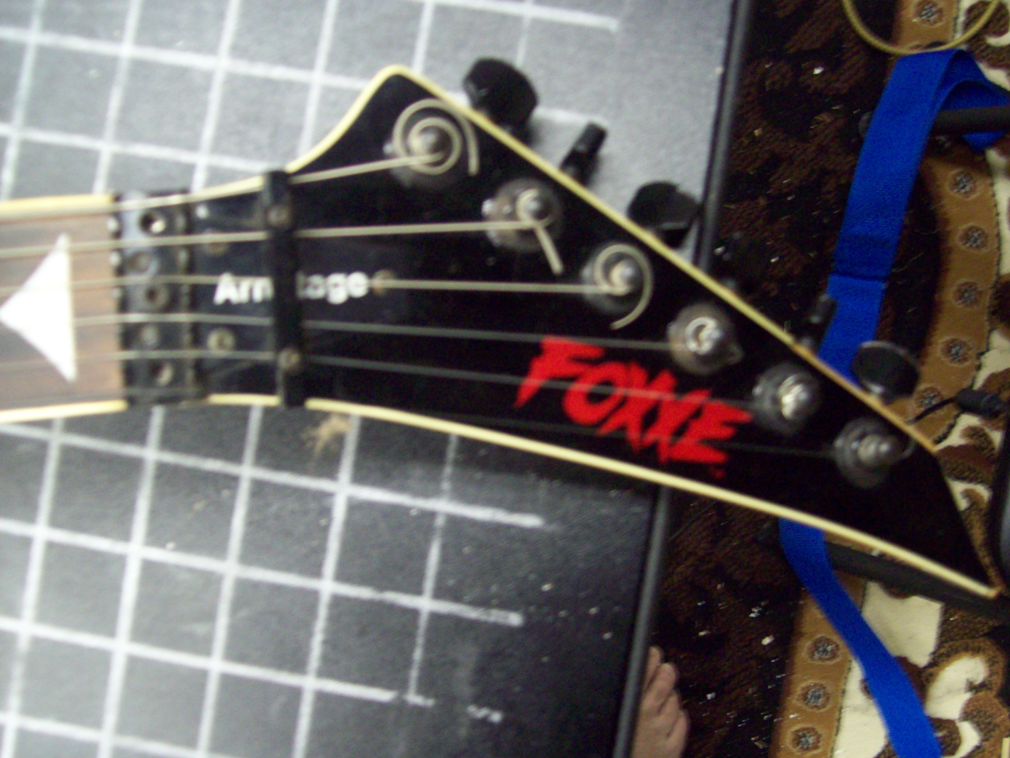

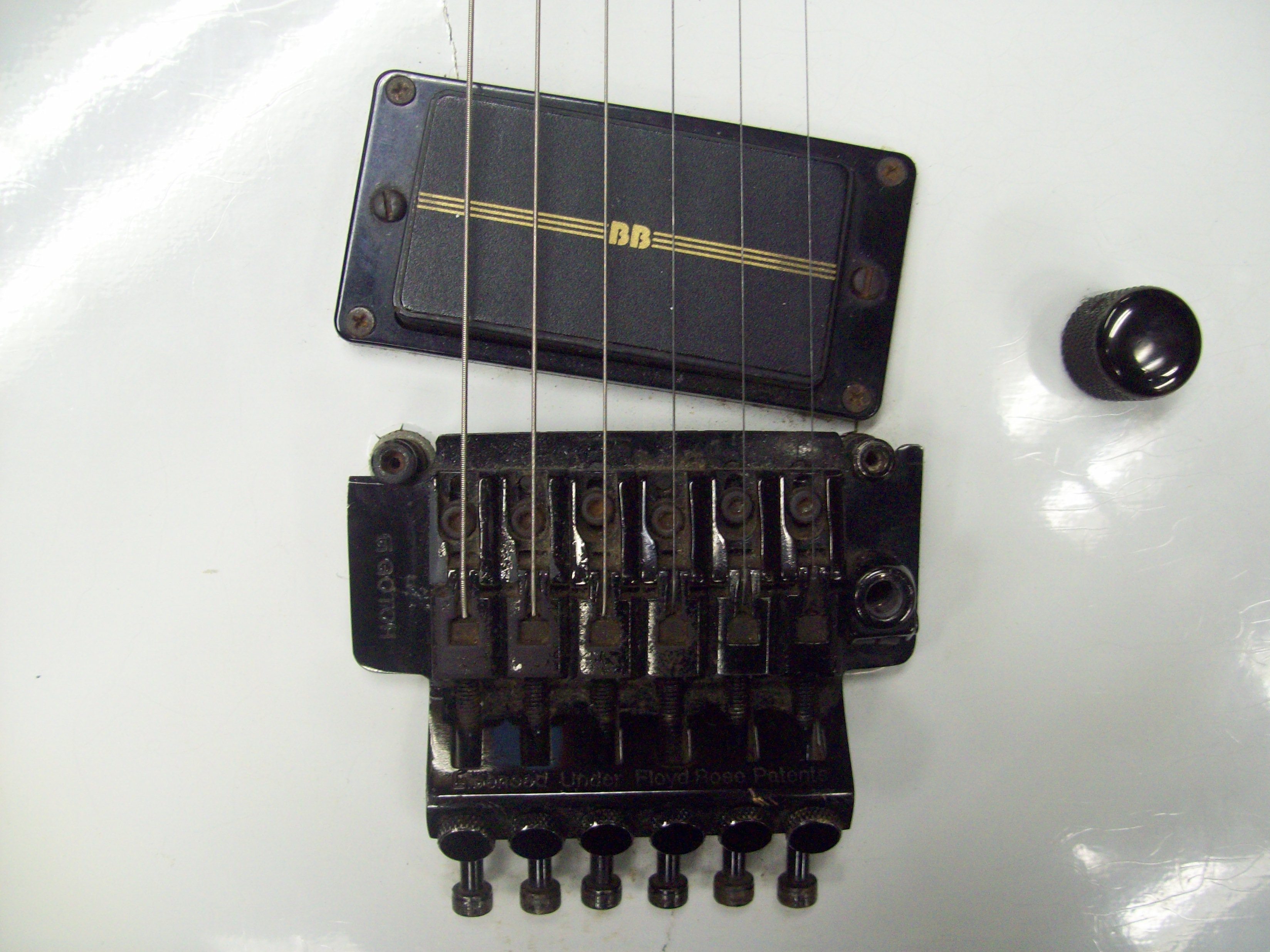

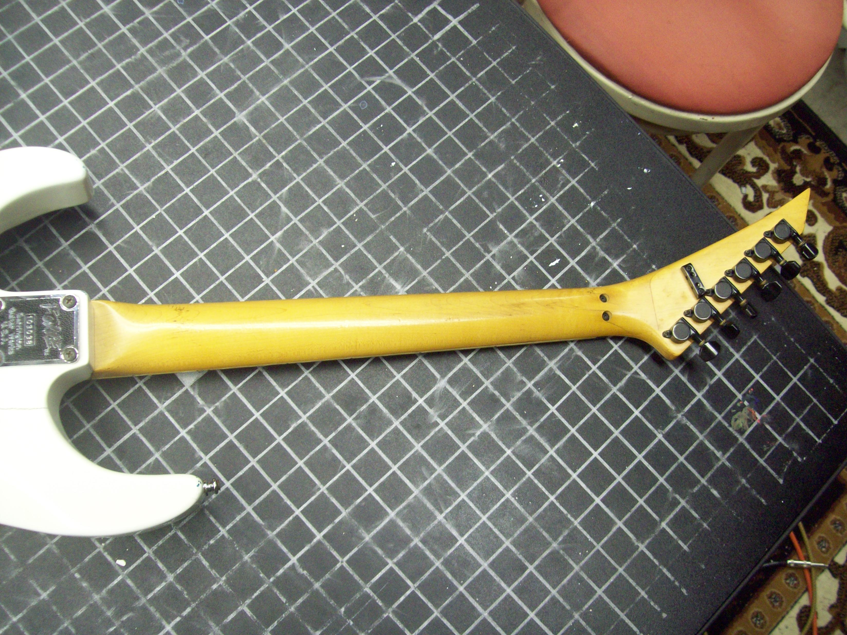

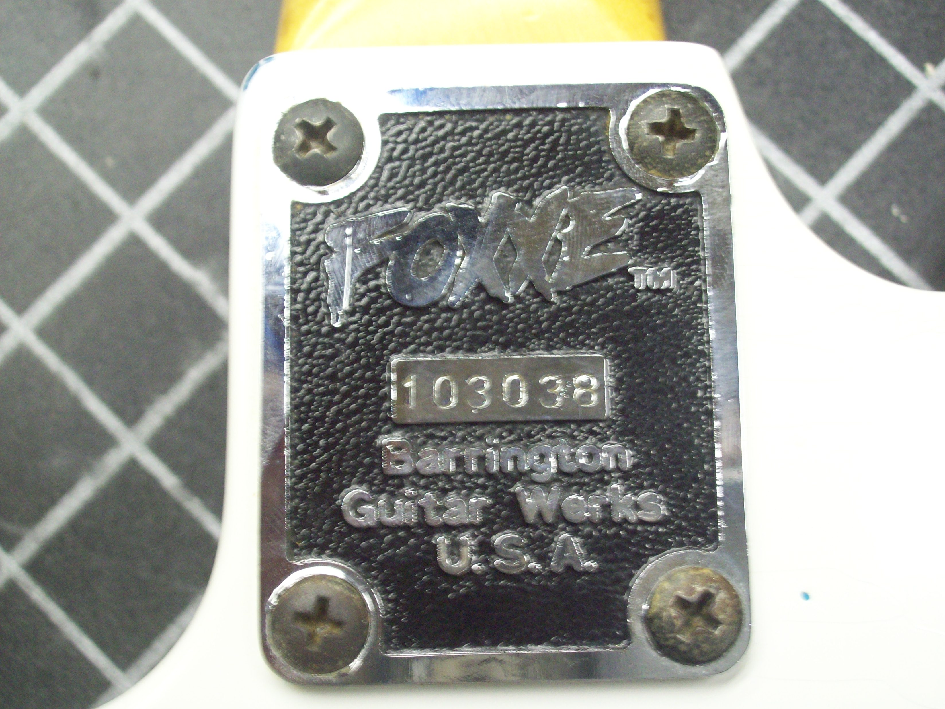

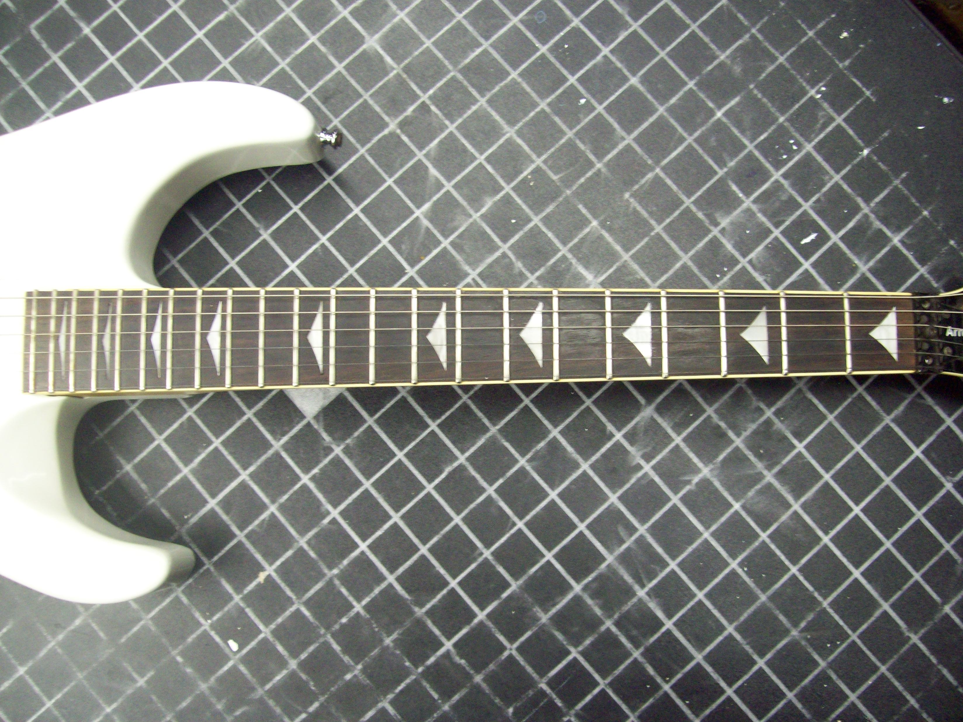

PostPosted: Thu Jul 21, 2011 7:00 pm
Here are the photos of the Axe in question any help is appreciated as well as advice on paint removal.
http://www.rivercityamps.com/electrafor ... 0_8394.JPG
http://www.rivercityamps.com/electrafor ... 0_8395.JPG
http://www.rivercityamps.com/electrafor ... 0_8396.JPG
http://www.rivercityamps.com/electrafor ... 0_8397.JPG
http://www.rivercityamps.com/electrafor ... 0_8398.JPG
http://www.rivercityamps.com/electrafor ... 0_8399.JPG
http://www.rivercityamps.com/electrafor ... 0_8400.JPG
http://www.rivercityamps.com/electrafor ... 0_8404.JPG
http://www.rivercityamps.com/electrafor ... 0_8405.JPG
http://www.rivercityamps.com/electrafor ... 0_8406.JPG
http://www.rivercityamps.com/electrafor ... 0_8407.JPG
http://www.rivercityamps.com/electrafor ... 0_8408.JPG
http://www.rivercityamps.com/electrafor ... 0_8409.JPG
http://www.rivercityamps.com/electrafor ... 0_8410.JPG
http://www.rivercityamps.com/electrafor ... 0_8411.JPG
http://www.rivercityamps.com/electrafor ... 0_8412.JPG
My goal is to get this one back to the original finish if I can. I think it may be a crackle finish underneath the white as the white finish shows the same line pattern on front and back which looks like a crackle type finish. Thanks Arthur :up:
PostPosted: Fri Jul 22, 2011 3:25 am
Simple and elegant... I also like the unusual triangle markers, cool. Some of those cracks look deeper than just the finish. Good luck getting that paint off, it looks like a lot of work. Maybe you can try some chemical tests in the tremolo route before you go for removal on the front.

Thanks for the info. No matter what the price quote this one was a free gift so i will be out just for the time to restore it. It is a very nice built and quality parts guitar. it plays and sounds great. Just needs some TLC and cleanup as the original nice blue paint finish was painted over and the original wires are still there but held together with duck tape. Some time to clear off the paint and some re doldering of the wires and she should be good to go. Thanks again :up:
